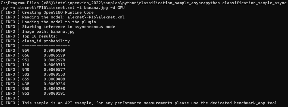

Hi Tithi,
I've encountered the same error message when providing incorrect path or missing image for the "-i" command when running the sample. Here is the error message:
Please provide the correct path for your image and ensure it is available in your directory. Here is my sample directory and the result for running the sample with the image:

Hi Tithi,
From my end, I was able to replicate this issue by using an empty image as an input and received the following errors:
On another note, you can verify whether OpenCV was able to read your image by accessing the image properties. To print the image properties, run the following command in a Python shell:
import cv2
image = cv2.imread("banana.jpg")
print(image.shape)
Here is the result of a valid image:
I'd suggest you to have a try using different test images from the media files collection available at
https://storage.openvinotoolkit.org/data/test_data/images/
Additionally, please do share your image files with us for further investigation regarding this issue.
