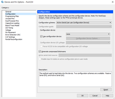

Hello, I am having trouble using EPCS16. Generating on NIOS II works well
but I get this error when I try to do a full compile in Quartus
"Error (176310): Can't place multiple pins assigned to pin location Pin_E3 (IOC_X0_Y34_N0) Info (176311): Pin ASDO is assigned to pin location Pin_E3 (IOC_X0_Y34_N0) Info (176311): Pin ASDO is assigned to pin location Pin_E3 (IOC_X0_Y34_N0)."
I heard that this problem can be solved by setting Device-dual purpose pin-User as regular I/O, but even after changing the setting, I still get the same problem. I am attaching my error message and Verilog HDL file for reference.
I am using Quartus II 13.0spi / DE2_35 board.
My pin assignments are as follows, and I did it according to the DE2-35 manual. The DE2-35 Pin Assignment did not have pin numbers, but I found them in the circuit diagram, so I referred to that.
PIN_E3 -to ASDO
PIN_D3 -to NCSO
PIN_N6 -to DCLK
PIN_N3 -to DATA0
by the way, I changed the file extensions for some files to upload them. By removing the "txt" at the end, you should be able to use them.
Thank you for reading this.

Do you only make changes to ASDO pin (use as regular IO), or do you also make changes to nCEO pin? Can you only change the ASDO pin in as regular IO?

Thank you. I only mentioned ASDO in my previous message, but in fact, nCSO also has the same issue. In the first image, two errors are reported. I will provide information on both of these errors:
Error (176310): Can't place multiple pins assigned to pin location Pin_E3 (IOC_X0_Y34_N0) Info (176311): Pin ASDO is assigned to pin location Pin_E3 (IOC_X0_Y34_N0) Info (176311): Pin ~ASDO~ is assigned to pin location Pin_E3 (IOC_X0_Y34_N0)
Error (176310): Can't place multiple pins assigned to pin location Pin_D3 (IOC_X0_Y34_N1) Info (176311): Pin nCSO is assigned to pin location Pin_D3 (IOC_X0_Y34_N1) Info (176311): Pin ~nCSO~ is assigned to pin location Pin_D3 (IOC_X0_Y34_N1)
Regarding your previous response, I can change the ASDO pin to AS input tri-stated. However, even if I compile it in its original state, the same issue still occurs.

looks like you have a second module besides nios2e that's connecting to AS memory. ASDO is the top level pin you have defined ~ASDO~ is something different. Specifying dual purpose pins as regular IO is basically correct when using user declared AS pins.
You can e.g. disconnect the nios AS pins by outcommenting the top level pins and check the compilation report to see what's connecting else. Can it be that nios is configured for internal AS memory connection and you are using the external pins erroneously?

Thank you for your response. I understood that "outcommenting the top level pins" means releasing the pins declared for EPCS16. If I understood correctly, I released the 4 pins declared for EPCS16 and compiled without any error messages.
The problematic pins are E3 connected to ASDO and D3 connected to nCSO. If only these two pins are reassigned and the code is recompiled, the same issue occurred.
Could not checking the "Automatically select dedicated active serial interface, if supported" option in the configuration when adding the EPCS controller to Qsys be the cause of the issue?

Before doing the compilation, did you try to do the pin assignment by yourself? Per my checking, you just need to leave the pin as it is.
Also, have you try to compile with the latest quartus version?

I’m sorry for the late reply. Actually, I couldn’t solve that problem, but I succeeded in using EPCS. I left it to automatically assign pins without manually assigning them, so I was able to use EPCS and succeeded in programming my code into FPGA. So I don’t think I can answer any more about that.
