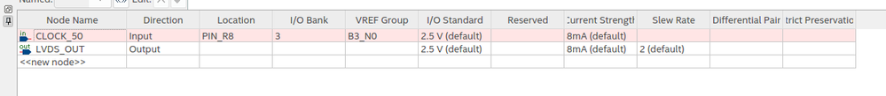

Hi, i have been trying to test LVDS functionality by creating an output as reg (not wire) and then setting its' val with a non-blocking assignment inside an always loop.
I started by creating a single output called lvds_out. I then created the symbol by running File->Create/Update->Create symbol files for current file. I inserted the symbol in the block-diagram form and run Analysis & elaboration. Then i got into Pin planner and i saw the pin that i created (as i should). As soon as i selected LVDS and hit ENTER the negative output was selected for me. I compiled and i got the error messages that you see in the attached images.
I am obviously doing something wrong. What is the process when creating a LVDS output? Is the logic same when creating LVDS inputs? Should i be having 2 outputs in my verilog (and accordingly in the block-diagram) instead of one?
Can you pls help me out here?

Hello there , Looks like from the message you are getting error in fitter. can you give me the device part number which you are selected in Quartus ? thank you, Regards, Sree

I obviously forgot to mention that i am using DE0-nano which has a cyclone IV E EP4CE22F17C6N FPGA.
I was able to solve the issue by selecting LVDS_E_3R instead of the LVDS. All i wanted was to just pass the clock to the LVDS output and measure it with my scope.
The error message itself proposed that solution which i saw later on (after posting my first message).

Hi again, i am very sorry for this but it seems that i have not been doing enough reading. I am at the very beginning of this so please accept my apologies. I have not been using the correct IO banks.
LVDS works fine as long as the correct bank is selected and by saying that i mean that the appropriate pins (that belong to the correct bank) must be chosen.
There is a reference on that in the cyclone IV handbook page 123/490 where the definitions of banks with their supported standards.

Hello ,
From the above your reply when you said LVDS_E_3R working then I understood that channel is not differential end pair...I was trying to find part number and pin mapping sheet whether particular channel support dedicated LVDS channel
and you confirmed it is not ..Good
First thing i would give some input about what is LVDS_E_3R..as you said you are at beginning .it is good to learn when you see things " LVDS assignment for non dedicated differential pins as LVDS_E_3R .This standard required 3 external resistors.
I can comment with cyclone IV E LVDS can support around 800 MBPS with provide clock speed.I am not sure about particular board. But i did see few folks mentioned in forum that they tried out and successfully.
