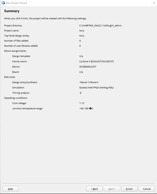

I'm having a problem too making Quartus prime run after. i enter some basic config data:
when i click finish after this it loops forever, if i decide to close the program it then wants to tell Microsoft. I suggest it may be something to do with i have resisted using the EDGE browser and when i gave me the opportunity to reload a I reloaded Firefox again by clicking the Firefox link on the list of browsers it gave.
It tells me all the time that my browser is unsuitable i suspect that because I'm not using edge Quartus has been disabled in some way by Microsoft just promote use of edge.

sstrell
8,170 Views
Your choice of web browser has nothing to do with whether Quartus will create a project.  Web browser choice is only used when you open Help in the tool.
Can you try installing on a different computer or a different location?  Perhaps it is a permissions issue with the location where you are installing.  Or maybe that Malwarebytes program has something to do with it.
