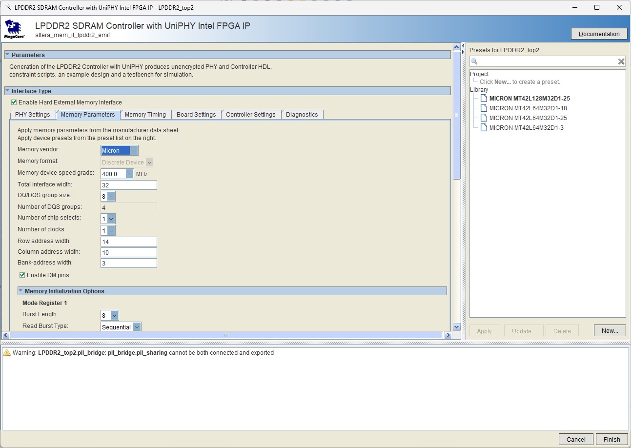

I am currently developing Cyclone VGX (5CGXFC7D7F27C8N).
I am using Quartus prim standard 24.1.
I purchased a board with LPDDR2-SDRAM mounted as external memory for 5CGXFC7D7F27C8N.
I am trying to set the hardware memory controller and generate the IP,
but an error occurs midway and the generation is not performed correctly.
The script displays a message that the Nios II environment is required.
The Nios II environment is not included in 24.1 and later.
Do I have to downgrade to Quartus prim standard 23.1.1, which includes the Nios II environment?

Hello, sstrell-san.
I am attaching a screenshot of the LPDDR2 MegaWizard settings.
I have also attached the error message I got when generating MegaWizerd.
I am planning to use nios V with the cyloneVGX "5CGXFC7D7F27C8N" and LPDDR2 implemented on this board.
I am having trouble generating the hardware memory controller included in this device.
Regards, Hidetaka.

So I tried to generate LPDDR2 IP again with megawizerd of Quartus Prime standard 24.1.
The error <Nios II Command Shell.bat> that appeared before has disappeared,
but the following error appears and I still cannot generate IP.
Error: Execution of script C:/Users/ueshima-h/AppData/Local/Temp/alt0222_1666408435099083815.dir/0008_LPDDR2_top2_gen/simulation/generate_sim_example_design.tcl failed
Error: Info: *******************************************************************
Error: Info: Running Quartus Prime Shell
Error: Info: Version 24.1std.0 Build 1077 03/04/2025 SC Standard Edition
Error: Info: Copyright (C) 2025 Altera Corporation. All rights reserved.
Hidetaka.

Hidetaka
3,777 Views
Hello,  Richard-san.
When I saw the error message, the error was in the "Info: LPDDR2_top2: Generating example design" item,
so I thought maybe I just shouldn't generate the example design, so I ran it, and it was generated without any errors.
Error: Execution of script "/0008_LPDDR2_top2_gen/simulation/generate_sim_example_design.tcl" is causing an error,
so I would appreciate it if you could fix this part.
Regards, Hidetaka.

Hidetaka
3,613 Views
Hello,  Richard-san.
I uninstalled Quartus Prime standard 24.1 and then reinstalled it.
I did not install CDT8.8.1 and generated the LPDDR2 IP again.
The result was the same; an error occurred when checking "Generate Example Design". If I uncheck it, generate completed successfully.
For the time being I will continue development without checking "Generate Example Design", but I would like this to be improved.
////////// error message
Error: Execution of script C:/Users/xxxx/AppData/Local/Temp/alt0224_5461300254259846718.dir/0008_LPDDR2_top2_gen/simulation/generate_sim_example_design.tcl failed
Regards, Hidetaka.
Hidetaka
3,106 Views
Hello Richard-san,
I had another issue in the Support Community. I added "TBB_MALLOC_DISABLE_REPLACEMENT=1" to the system environment variables that Adzim-san told me about, and was able to generate the Example Design without any errors.
See here.
I am unable to generate the Cyclone VGX LPDDR2 controller IP due to an error. - Intel Community
I am very grateful to you.
Please close this issue.
