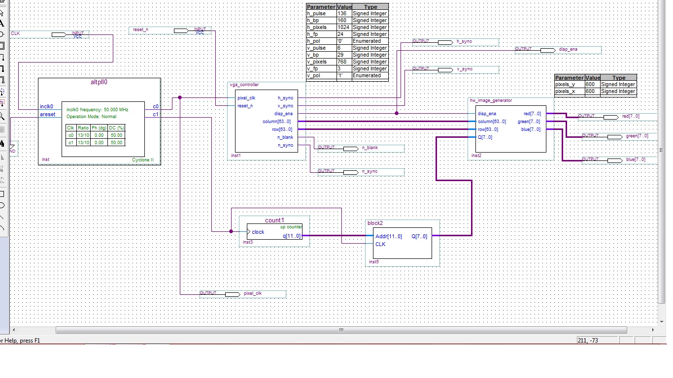

Hi guys.
I am having problem about my VGA monitor. I already have output on my VGA monitor. But now I am confuse about the output. See my attachment for the output. Here is my coding for the VGA monitor for last part. I want to display color based on my rom. If the content in rom is "128"(decimal), it will display WHITE color on VGA monitor else black color. But now the output seems have something wrong. Sorry for my bad explaination. Anybody who got idea abot my problem. Thanks for your attention.

The code you've posted looks (approximately) right. However, you've not posted the code that's responsible for the problem.
How do you generate the relative timing between the control signals and the RGB data going to your VGA device? You don't say what hardware you're using - is it a development board or your own? You must be generating horizontal & vertical sync signals as well. The issue is in the timing of these signals with respect to your column/row lookup for your colour data.

Your process is also missing the Q signal from the sensitivity list, so it will not function correctly in simulation.

Thanks Alex and Tricky for your feedback.
Here is my full digaram (attachment). And here is my full coding for vga controller. I am using altera de2 115 board.

Have you simulated the code to ensure it produces the correct and expected behaviour?
