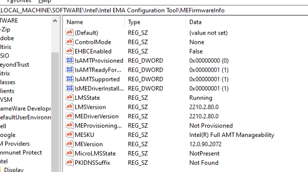

I am seeing the error on the EMAAgent log for a machine that has just had EMA Agent installed:
"Packet is not encrypted correctly or uses an old key. Last error: 0"
Our installation process is as follows:
  • Install IME drivers + Configure LMS service to Automatic
  • Reboot
  • De-Provision AMT (if provisioned)
  • Reboot
  • Install EMA Agent
    • Then we sometimes see the error.
We haven't fully deployed EMA to our estate, but the fact I saw this error during my testing is worrying me.
Why exactly does this error happen? If AMT is de-provisioned this error makes sense as the AMT chip should be welcoming the EMA provisioning???

 Hi all,
If anyone else gets this issue, I managed to fix it.
  1. Open up PC - Pull out CMOS battery (it was a DELL precision 3630)
  2. Wait 20 minutes
  3. Go into MEBx (BIOS) set new default password
  4. Turn machine on
  5. Machine then successfully provisioned AMT agent

Jools86
New Contributor III
4,138 Views
HI Jose,
I got past this error (dont know how), but machine not provisioning https://community.intel.com/t5/Intel-vPro-Platform/AMT-provisioning-keeps-failing/td-p/1434923, so something wrong with AMT on device.
We are using a DigiCert certificate (which is unchanged and provisions other machines) and have successfully provisioned this machine before
2022-12-02 09_10_43-Intel® Endpoint Management Assistant and 4 more pages - Work - Microsoft​ Edge.png
The AMT version of the machine is: 12.0.90.2072:
Please see my other post (for where I am now) https://community.intel.com/t5/Intel-vPro-Platform/AMT-provisioning-keeps-failing/td-p/1434923 for where I am now with this machine, after resetting AMT chip in BIOS multiple times.
