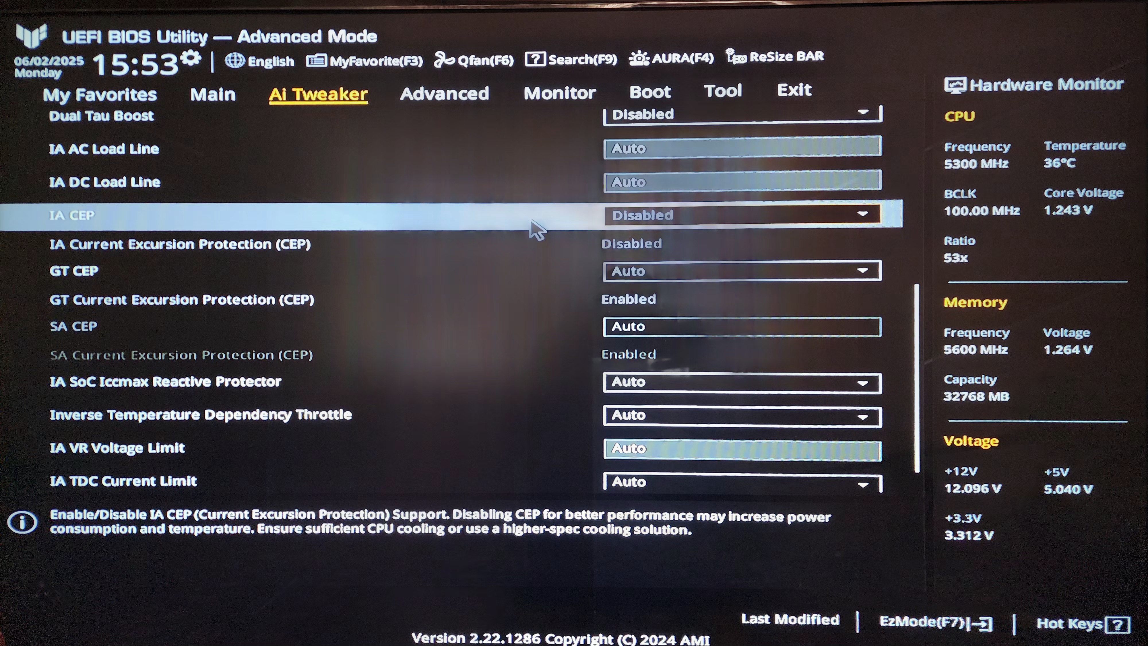

I built my new computer a week ago, and when I was testing it with XTU, both POWER LIMIT THROTTLING and EDP LIMIT THROTTLING were showing up, and the CPU temperature was reaching up to 95°C.
I searched online and found a suggestion to disable IA CEP in the BIOS. After disabling it, it felt like a barrier was removed from the CPU, and everything seemed okay.
The only thing I’m concerned about now is that during testing, the PACKAGE TDP reaches up to 165W. And IccMax value is 511A.
Are these high numbers? The CORE Voltage is at 1.2V.

1) It is 1805
2) It is under the cooling pump now but it was ok
3) Before changing BIOS yes. Only overheating to 95 degrees. After the change, no more overheating
4) No I haven't overclocked. just turned on the XMP
5) I just changed profile to asus because everything was greyed out then just the IA CEP

Yes. As I said in the first post with intel default settings, POWER LIMIT THROTTLING and EDP LIMIT THROTTLING were showing up, and the CPU temperature was reaching up to 95°C.
And now everything is fine. This is my workstation and after the change Adobe Premier works so much smoother.
