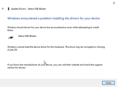

 USB Blaster is not recognized correctly in the device manager and it showing warning symbol. and device is not started with below  error massage
Device USB\VID_09FB&PID_6001\91d28408 had a problem starting.
Driver Name: oem33.inf
Class Guid: {36fc9e60-c465-11cf-8056-444553540000}
Service: AlteraUSBBlaster
Lower Filters:
Upper Filters:
Problem: 0x27
Problem Status: 0xC000007B
Can you please help me to resolve the Issue. I am using Intel Quartus 17.1 version , to resolve the issue I Installed / reinstalled and restarted the PC many times but it is not helping me to resolve the Issue.
and the below error massage on the general Tab on the device manager
Windows cannot load the device driver for this hardware. The driver may be corrupted or missing. (Code 39)
{Bad Image}
%hs is either not designed to run on Windows or it contains an error. Try installing the program again using the original installation media or contact your system administrator or the software vendor for support. Error status 0x

INITDONE
6,247 Views
Hi  Aiman , Ak6dn
Thanks a lot for your help.
Intel USB Blaster is working on windows 10 version 21H2  with  Intel® Quartus® Prime Standard Edition Software version 21.1 drivers.
Older software version also working with 21.1 drivers , just replaced the old driver folder with 21.1 driver and it is started working fine.
Thanks & Regards,
Ramesh S.

INITDONE
8,049 Views
Hi Ak6dn , Aiman
 while updating the driver for USB Blaster , I get the below error, may be the below error will help you to understand my issue.
Thanks & Regards,
Ramesh
