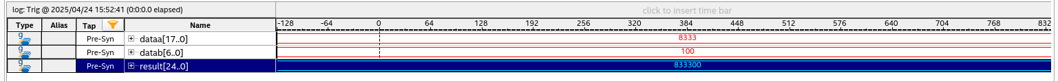

I can't get a simple LPM_MULT instantiation to work. It simulates fine in Questa, synthesizes in Quartus Prime 24.2.0 Build 40 06/27/2024 SC Pro Edition without warnings, but 'result' is always 0 with 'dataa' of 8333 and 'datab' of 100. The FPGA family is Cyclone 10 GX. I can post additional code and a screenshot of the SignalTap upon request:

Component is pipelined with one clock, unsigned. I've tried adding synchronous and asynchronous resets. 'datab' is a constant in this case, and I've tried instantiations where I specify 'datab' as a constant. 'clock' is a free-running at 100 MHz. All attempts yield a 0 'result'.

Here is a screenshot of the Signal Tap instantiation. The 'toggle_h' signal is a D-type flip-flop toggled at 100 MHz. Signal 'act_frame_time_h' is 'dataa' of the LPM_MULT instantiation. Signal 'act_frame_clocks_h' is the 'result'. Signal 'datab' is 'clks_per_us_h' defined as follows:
constant clks_per_us : natural := 100;
constant clks_per_us_h : std_logic_vector (6 downto 0) := conv_std_logic_vector (clks_per_us, 7);
The 'X' you refer to is part of the instantiation declaration and is superseded by the argument 'clk_r' which is the 100 MHz clock associated with the parameter 'clock'.
