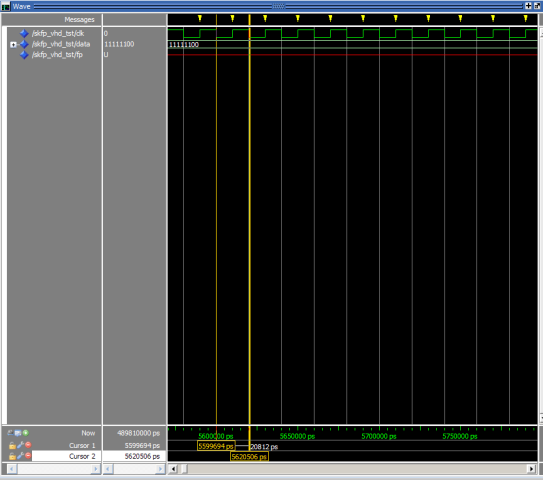

The problem is, when I use the RTL level simulation, I found It's not right.
this is the simulation printscreen.

It's due the differences in initialization.
In the RTL simulation, the registers are initialized to "X" or "U", since this is what the VHDL and Verilog specifications call for.
In gate level simulation, the registers are initialized to "0", since this is what the FPGA actually does.
There are two ways to handle this.
1. You can specify initial values for the registers.
2. You can add a reset signal to the module and make sure the testbench performs a reset at the beginning of the simulation.

It's normal simulation behaviour. The fp unknown state is copy from the variable temp in your design. While the gate level simulation reflects the default power on initialisation of registers, in functional simulation all signals are considered "unknown" unless you specify an initial value or use an explicite reset. This apllies at least to the variables temp and count.

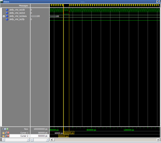

This is the printscreen:
http://images.cnblogs.com/cnblogs_com/tdyizhen1314/257630/r_mo3.bmp

As I mentioned above, the variables temp and count needs initialization. Without resetting count to a defined value, your design won't work in RTL simulation.
As a side remark. Your above design is using a ripple clock (the output of one process is used as a clock in another process). This is legal VHDL, but not recommended coding style, because it creates timing issues for other signals, that are fed from the first to the second process. You don't have them now, but most likely will in a more complex design.
The problem and possible solutions ("clock enable method") have been discussed frequently in Altera forum and are covered by VHDL text books.

Yes, your design is missing a reset expression for count.
