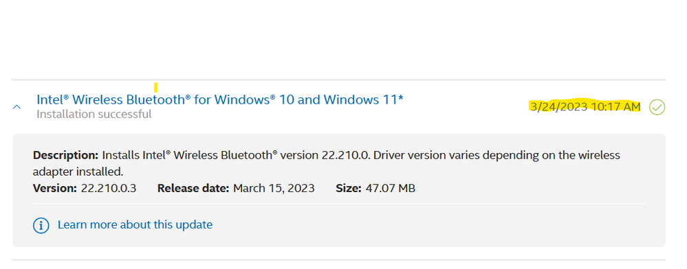

Sjfke
21,921 Views
Hi... I have exactly the same error....
So far the only issue is not being able to update OneNote via the Microsoft Store.
OS: Windows 11 Home Version 22H2 (OS Build 22621.1485)
I'll wait for your reply *before* trying to fix... first step will be Cleaner Registry clean up.
2023-03-24 10:17:08 BullseyeCoverage 8.25.21 error 15: Cannot find C:\WINDOWS\Temp\da14fc5edcdde95d23ab09780013827cfb7e12/test.cov, errno=2 "The system cannot find the file specified. ". COVFILE is not set. Program=c:/Users/gjayap/HaraHaraMahDev/ibt_core-win-hsw/ibt_win_src/06-host_sw/win/bin/setupres/Release/Win32/setupenu.dll
Who the hell is 'gjayap'? Maybe an Intel developer?
The error corresponds to the exact installation date/timebullseyecoverage.png

Sjfke
21,799 Views
Thanks guys for finally getting some traction on this issue...
Like the other posts suggest ... please look into why this is happening, and let us know what to do especially if this is a security breach.
I successfully applied this months Microsoft patches and the OneNote issue was fixed by opening the application and it warns I need to install an update, which I did and Microsoft Store update no longer appears. So my personal Windows 11 Home Edition laptop appears to be OK.
FWIW: I actually applied two updates at the same time, Wifi and Bluetooth, see attached image.
Running "CCleaner" (quoted to avoid auto-correction messing with it like last time), I checked the registry and I did not see anything reported related to either of these Intel updates, just the usual garbage left behind from various other updates.
Sjfke (https://github.com/sjfke)

Kind of hard not to believe they are related.
I've attached a copy of both my install history and the Bullseye file.
