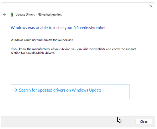

TomHolm
8,976 Views
Tried installing the 22.250.0.4 aswell, but it cannot be installed on our newer HP laptops with the new AX211 revision.
It just says "Windows could not find drivers for your device".
