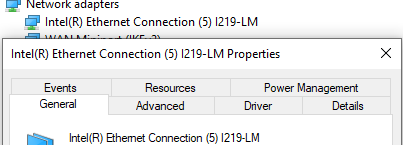

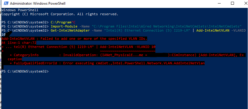

NOklo
9,987 Views
Hello Everyone
Just got installed 23.5.2. SAME PROBLEM!
I can't manage to add VLANs!!
NOklo
9,987 Views
NOklo
9,960 Views
Caguicla_Intel
9,960 Views
Hello NOklo, The Teaming and VLAN features in PROSet for Windows device manager have moved, as Windows 10 1809 and later no longer supports this function. Please use PowerShell to create VLAN. To create a VLAN in PowerShell use the following: 1. Open Windows Powershell as administrator. 2. Import the PROSet Powershell* module using this command: Import-Module -Name "C:\Program Files\Intel\Wired Networking\IntelNetCmdlets\IntelNetCmdlets" 3. Type "Get-IntelNetAdapter" to display the name of your network adapter. 4. Type "Add-IntelNetVLAN" to initiate the creation of VLAN. When prompted for "ParentName", you can use the name of your network adapter from the "Get-IntelNetAdapter" output. The PowerShell commands for Intel PROSet are described in the following link: https://www.intel.com/content/www/us/en/support/articles/000023545/network-and-i-o.html You may also refer to the link below to check what's new on this release for Intel(R) Network Connections Software Version 23.5.1: https://downloadmirror.intel.com/22283/eng/readme.txt Please let me know if you have any other questions. Best regards, Crisselle C Intel Customer Support Under contract to Intel Corporation
NOklo
9,960 Views
Hello CrisselleC,
I didn't know about incompatibility windows 10 1809 and Intel VLAN tab. Thank you!
Any way I did exactly what you wrote:
What I did wrong?
Execution of command above just drop timeout for 1-5 minutes and turning off interface without creating any virtual interface for VLAN.
It's frustrating being not available to work at computer!
