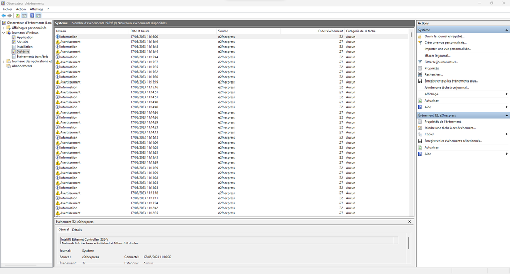

alexisdaeron
13,926 Views
I have the same problem with a MSI Z790 MPG Edge Wifi with the BIOS Update and the Last Driver Intel. It worked for 1 month and you have the result in image. EEE désactivated
