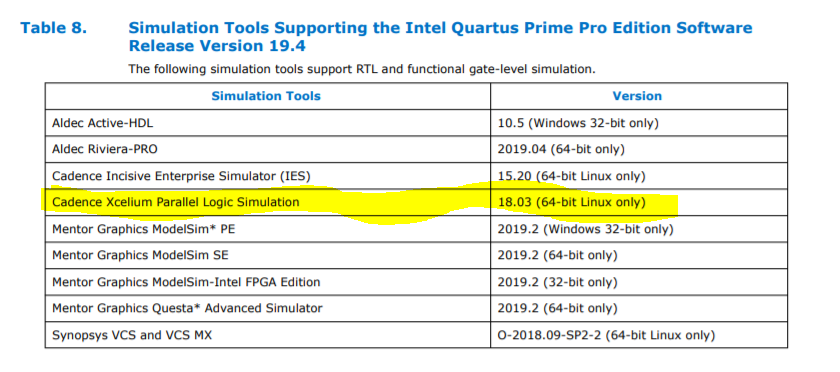

Have you try to used this supported tools version for Xcelium for Quartus 19.4?xcelium.PNG
Also may I know which memory simulation model are you using (for example Micron or etc)?

Thanks for your reply. I will check the simulation results with 2018.03 xcelium version. I have been using Micron memory model.

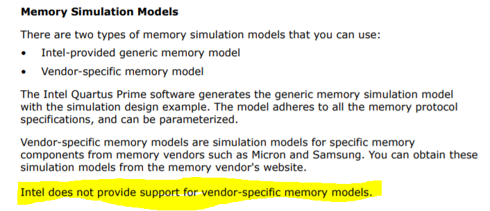

Thanks for the confirmation regarding memory model. I reached out to our internal engineering team for assistance and they are telling me we do not support vendor models since they have very stringent checks trigger during calibration. I also re-confirmed the statement on our documentation and it does state that we do not support these models. See Below.
Sincerely sorry I do not have better news for you. But, please let me know if there is anything more I can help.
