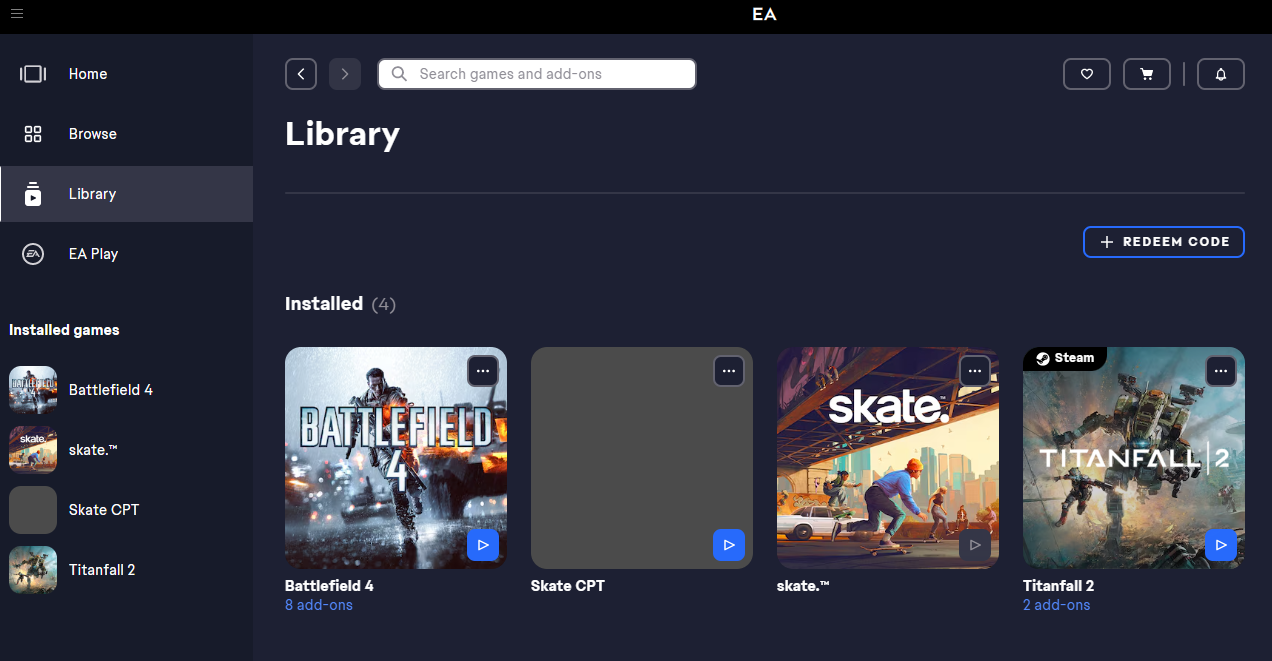

Hello FlamePaladin,
- What is the model of the Graphics controller?
- What is your game launcher?
- Let me check, are you using the official released game or is it a demo?
- Can you share the screenshot of the Graphics settings of the game.

1. Phantom Gaming Arc A770 8GB OC Edition (did you mean model number?)
2. EA Launcher
3. it is official insider access release. The File named Skate.png has a picture of my EA Launcher, I Launch the game using the the picture with skaters called Skate.tm not Skate CPT.
5. I have tried uninstalling graphics driver using DDU and reinstalling, new windows update which downgraded my driver to the one that is shown in screenshot then I used DDU again then i always use the Intel Driver and Support Assistant to reinstall my drivers/update them. i have lowered the graphics to lowest possible/ I used FSR instead of XESS, I tried Native rendering instead of both of those. I tried all combination of settings always with depth of field and Motion Blur turned off ( I hate both of those settings, i always turn off). I closed everything in the background as well as left everything open several times and it doesn't make a difference. According to the fps counter by the Xbox game bar i am getting anywhere between 110 to 180 fps depending on area and how busy it was, and according to HW monitor the game wasn't using more than 7gb vram total running everything and card doesn't go over 61 degrees Celsius.
