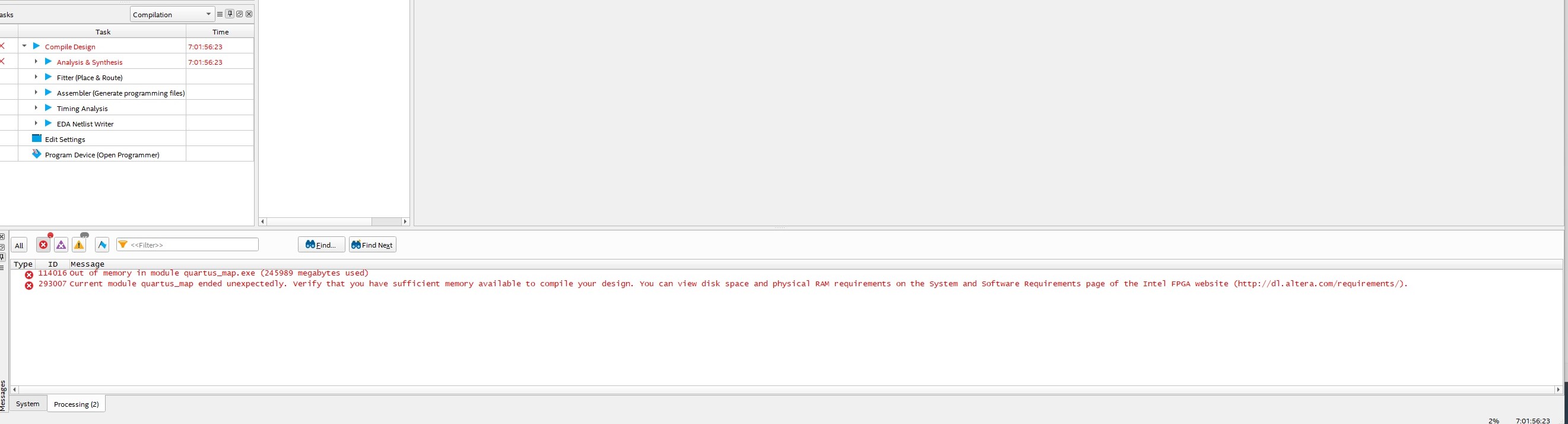

So my design needs to be simplified. I have lots of loops, over 1000 loops. After 7 straight days of just in the initial seed of the compilation (2%) just analyzing the design, Quartus issued a message out of memory. I checked Task Manager, and it quit when it reached 65% of total Ram usage. It was still using 1 processor core.
I'm unable to comment weather past this stage and into the fitting stage if it does in fact use more than 1 processor core. I do have it set to use 8 cores. I have ram usage to "Default", but I have 128 GB Ram and it used 75GB of that as reported by Task Manager, and quit.
I'm closing this thread out because my design needs to be simplified and I cannot speculate further.
