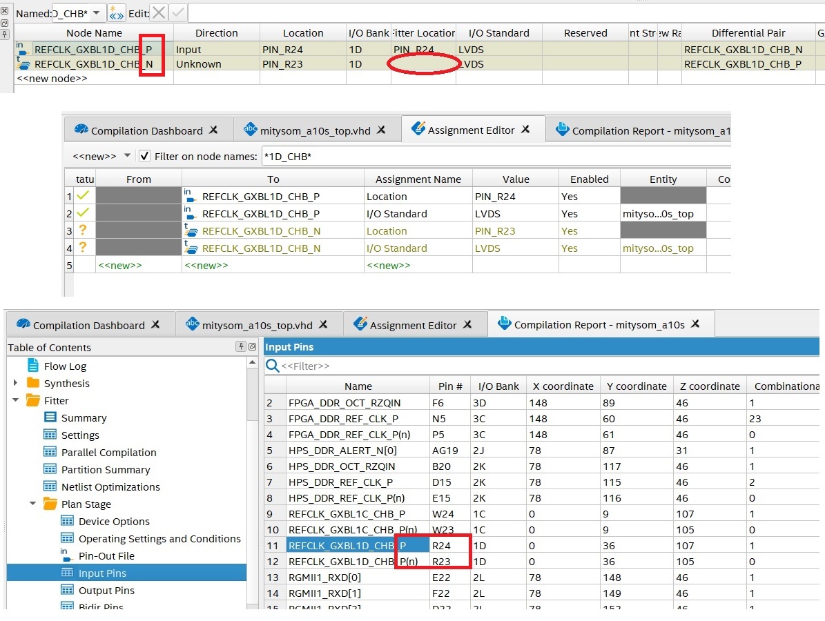

I am working with SOM board with Arria 10 SX on it.
Signal Tap does not see differential clock signal from external freq generator. In the same time I see frequencies on external generator output pins (by oscilloscope).
Quartus 18.1 Pro. Compilation of project is finished successfully.
External clock generator (SI5338) prepares 2 frequencies: 125 MHz and 322.26 MHz as differential signals.
These signals connected to U24/U23 (REFCLK_GXBL1C_CHT_P) and W24/W23 (REFCLK_GXBL1C_CHB_P) pins.
I added some assignments in Assignment Editor regarding these signals (see attachment).
But FPGA project does not receive these signals.
I coded simple counter and instantiate it on each of frequencies: 100 MHz (USER_CLK from HPS), 125 MHz (from ext generator) and 322 MHz (from ext generator).
I see signal on output of counter (out signal pulse_out) on 100 MHz only. On the outputs pulse_out of 125 MHz and 322 MHz counters there is nothing.

GXB transceiver are dedicated hardware and not part of the FPGA fabric. Their refclk input can't be tapped by Signaltap.
Hi, FvM
Thank you for reply.
I tapped not REFCLK input immediately, but output of counter which feed from REFCLK. Or does it not matter?

So you're trying to tap signals operating at about 1 MHz and about 2.7 MHz? Then you have the opposite problem of what I mentioned. The signals are so slow that they don't appear in the time seen in the capture buffer. What is your trigger condition? If you trigger on these divided signals themselves, you should be able to see them.

After first compilation the default FPGA project from GIT I see inconsistency between Pin Planner and Assignments from one side and results in Input Pins (Fitter report) on another side. You can see all that in attachments.
I think this result obviously do not allow to work the project in right manner.
It seems to me that this behavior is due to the fact that by default Quartus for signals of the LVDS type automatically creates a pair with the addition of "(n)" to the end of the name of the second signal. But by default, a pair of signals with the names "..._P" and "...N" is created in the project.
Unfortunately, Quartus' work with assignments is not a strong point. Changing assignments creates "garbage from old values" in assignment files, which have to be deleted manually (dancing with a tambourine).
After some effort, I cleaned out the assignment history and brought project into the desired state (After correction.jpg).
But this activity do not move me to desired result. (((
Faced with the need to manually intervene in editing the assignments, I'm not sure that I corrected the situation in full.
