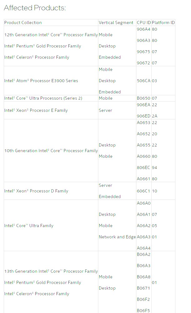

Thanks for replying. Unfortunately, processor i5-13500 does not affected by the Vmin Shift Instability Root Cause
I am asking about this issue. Intel® Slim Bootloader identified on 13th May 2025.
INTEL-SA-01290
I need the above issue. microcode.

I believe the details of Microcode 0x3a was already shared in this thread.
Additionally, you may contact the manufacturer of the motherboard also for further assistance.
