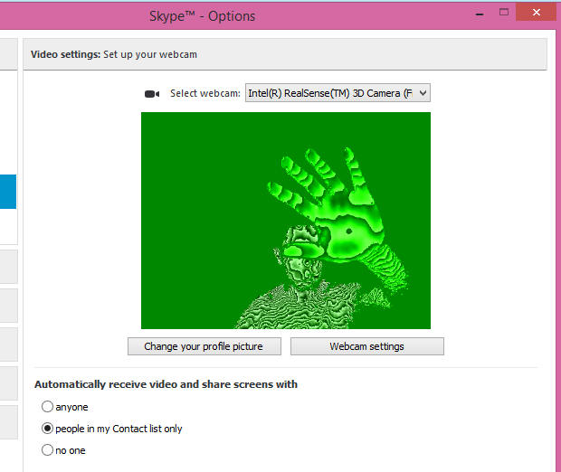

Yu G. wrote:
summary:
There are 4 installers from official website:     1. Driver  2. Firmware  3. DCM   4. SDK
1. After installing driver and plugging camera into PC, I find 3 changes in Device Manager (see image in #22)
    a) Audio Inputs and Outputs - Microhpone Array (Creative 3D Gesture Camera VF0800)
    b) Imaging Devices - Inter(R) RealSense(TM) 3D Camera (Front F200) Depth
                                      - Inter(R) RealSense(TM) 3D Camera (Front F200) RGB
    c) Univeral Serial Bus devices - Intel(R) RealSense(TM) 3D Camera (Front F200)
2. When installing firmware: there's a error message: Creative 3D Gesture Camera VF0800 is not connected.
3. When installing DCM, there's a error message: The installer failed to detect an Intel® RealSense™ 3D camera on this system. The installation was terminated.
4. When installing SDK, there's a warning message: The installer failed to detect an Intel® RealSense™ 3D camera on this system. Certain SDK features require an Intel RealSense 3D camera.
Also I found that I can call depth camera in Skype.
