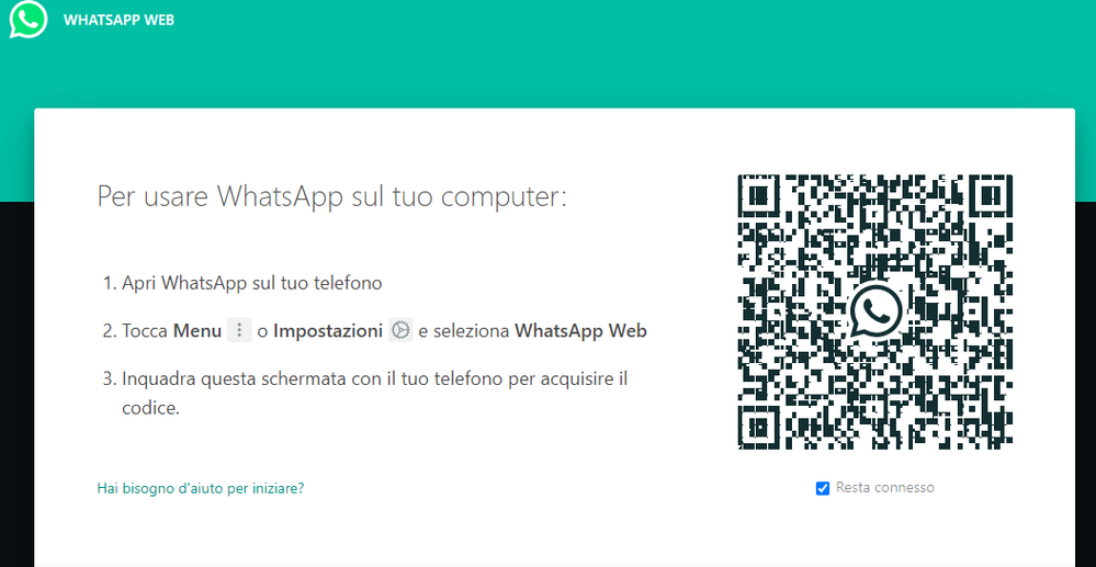

This does not only happen in WPF apps. Graphical glitches are also present in websites for browsers based on Chromium (such as Chrome and Edge), which makes the QR codes for signing in to Discord and Whatsapp garbled and thus completely unusable:
graphical-glitch.png.77989c813a8265dfea7562f97defee8c
Amazon's website also has random graphical glitches:
 unknown
Visual glitches in Discord's web app when hovering over server icons:
I'm very surprised to see that this bug has been known since November 2020, affects such major software as WPF and other frameworks/apps that use hardware acceleration (including Chrome and Edge) and has still not been fixed.

I have exactly the same problems like nls using a brand new Dell XPS 8940 with i7-11700 and UHD 750 graphics under Windows 20 home 20H2. The graphical glitches while looking at websites such as WhatsApp Web or Amazon I could eliminate by switching off the hardware acceleration in my browsers (I use opera, vivaldi and edge). I couldn't eliminate this glitches while using apps like the Signal messenger. There I was not able to link my smartphone to the computer because the QR-code was not readable.
But today I installed the beta driver igfx_win10_100.9616.exe from here: https://downloadcenter.intel.com/download/30500/Intel-Graphics-BETA-Windows-10-DCH-Drivers
After restarting my computer the glitches didn't appear. I'm very happy with this!
By the way: the graphical glitches did never appear under UBUNTU, when I booted my machine from an USB-stick.
